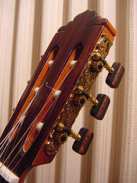

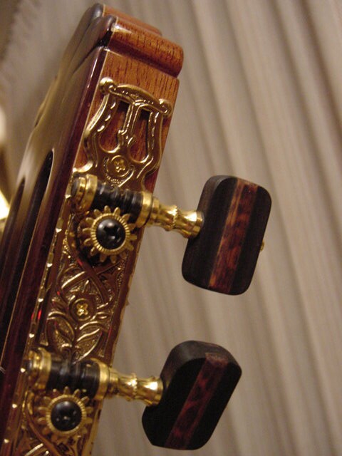

PostPosted: Sat Jun 16, 2007 11:52 am
Posts: 535
First name: Pete
Last Name: Liccardello
City: Eden Prairie
State: Minnesota
Christian,
Here are two photos of a set of ebony & snakewood buttons that I made mounted on Gotoh classical tuners. They were a fun side project and the Gotoh tuner buttons are removeable with screws on the shafts so they didn't have to be pulled off with any special tooling.
Peter
PostPosted: Sat Jun 16, 2007 12:27 pm
Posts: 587
Location: Tacoma, WA
Those look really sharp, that is part of the reason I wanted to do it - it could be a laminated piece. Thanks for the pics! Was this a difficult process?
Christian
PostPosted: Sat Jun 16, 2007 1:28 pm
Posts: 535
First name: Pete
City: Eden Prairie
State: Minnesota
Christian,
I took a 6" long piece of ebony and routed the slots on each side to inlay the snakewood. The snakewood was a leftover piece of binding. If you look closely you'll see that there still is about 1/16" of ebony between the two inlaid pcs. of snakewood.
After inlaying the snakewood I drilled the holes for the tuner shafts using my dremel drill-press set-up. I then cut the log into the 6 pcs. and used a very small modelmakers square file to square the holes in the buttons so they don't spin on the tuner shafts. The last thing I did was to shape them on the belt sander and some final filing and sanding with 600.
Peter
